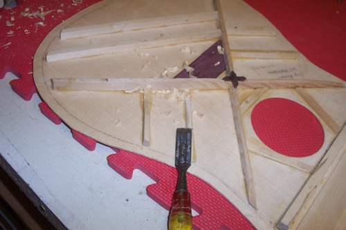

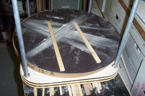

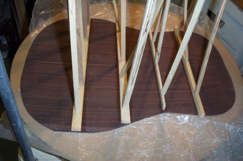

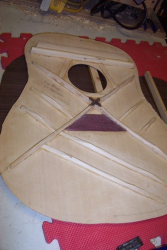

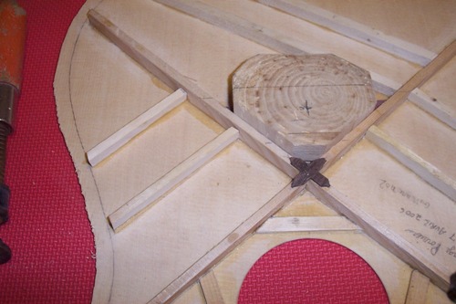

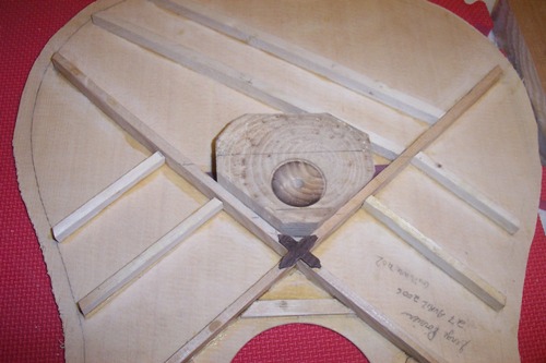

Hello folks, that is what's been done so far, i shaped-radiussed and carved my braces for the top and the back plates, sanded the rim for the back plates, made the notches for the back braces ends and glued the back on the rim.
Here are a lot of pics
radiussing of the braces

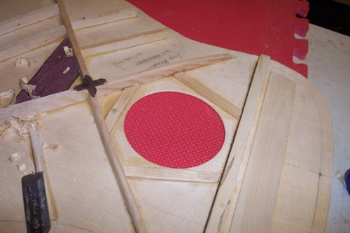

Clinton, i also made a clamping caul, thanksfor the reminder

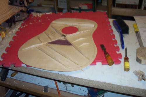

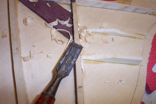

Then i started carving the braces for the top
Love them shavings
some more carving of the top braces
Gotta stop here for those with dial up but i will start another thread for the following pics! Thanks for watching and if you see something wrong, please feel free to crique, especially my bracing.

WTG Serge-Sure is lookin good Bud!Do you use any finger planes for carving your braces? They really work good for that.Keep on a buildin'

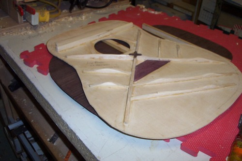

In this picture, it looks like all the braces are different widths and heights.
Just wondering if your following a book or plan of some sort.
Looks like it will all come out fine though, great progress there Serge.

Had me worried there for a bit until I saw the pic with the bridge plate caul removed!

Dave, no, i only used my 3/4" chisel but i'm considering building me some!
Rod, as always you have a good eye, yeah, i do follow a plan but was curious to play with the second one from the upper bout or b-2 from my plan because it's right underneath the soundhole, just a feeling kind of thing!

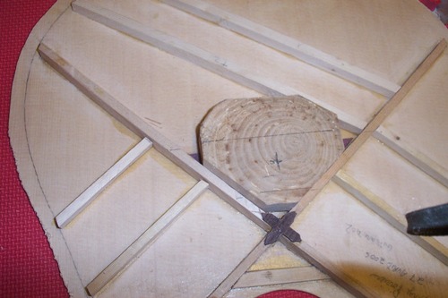

All right,looking good! I like that caul, it looks like a cut off from a tree branch. Are you following a plan? Looks like you'll be boxing it up in no time now. It took me the same amount of time on the neck as it did on the box. Unbelievable. Keep those pics coming. Clinton

Clinton, you got a good eye too bud, it's a small log that was cut on the premises where i work! Yep, i follow a plan for a dread from LMI, PL11 to be more precise but i deviate from it from time to time, THANKS

Thanks Pat, i guess we posted at the same time so i had missed your post! Yeah, looking back at the pics, the clamping caul was really taking all the space huh?

Wow, Serge, it really looks good. You're going to beat me finishing #2. I still haven't been back in the shop for about a month now. I did get my drill press part finally and I'm almost finished with my granddaughters swing/play set, so hopefully I can get back to building by next weekend.    I only use a chisel on my braces too. That spruce is so easy to carve, it's not a problem. I do rough shape the braces on the bandsaw and drill press sander before I glue them in and then final shape with the chisel.

I think I recognize the bridge plate.
BTW, make sure you keep in mind how wide your binding is going to be. Ask me how I know this.

Coe, yeah, the bridge plate is purple heart, i thought it would look neat and no 2 is great for experimenting on things like that! Now, you tickled my curiosity about the binding width, how do you know this? Thanks
